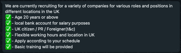

After being provided with their checklist (Figure 2), a step less about finding top-quality job candidates and more about finding suitable victims, the scammer, or more likely their automated process, hands me over to a seemingly human agent to gain further trust and reel me in.
![Figure 2: Desired victim checklist [WhatsApp message]](/wp-content/uploads/work-hard-pay-harder-figure-2.png)

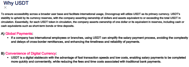

We expect scammers to avoid traditional payment methods because bank transfers can be tracked and potentially reversed. As for why Tether is the scammer’s cryptocurrency of choice, they attempt to provide an explanation within the scam portal (Figure 3).
![Figure 3: Explanation of why to use harder-to-track USDT [Scam portal]](/wp-content/uploads/work-hard-pay-harder-figure-3.png)
This is, of course, all part of the illusion of legitimacy. The scammer likely prefers Tether as it is pegged almost one-to-one with the U.S. dollar, making it easy to understand for those of us unfamiliar with crypto-markets and avoiding the volatility of Bitcoin (BTC).

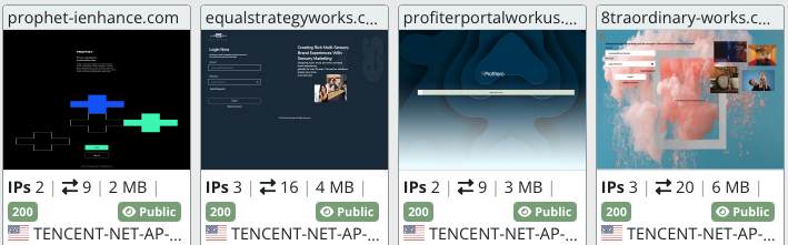

Starting with the IP addresses that the portal domain resolved to (Figure 4), it was evident that hundreds of similarly structured domains were active at any one time, mimicking numerous brands.
![Figure 4: Example IP pivot linked to additional scam domains [URLScan]](/wp-content/uploads/work-hard-pay-harder-figure-4.png)
Consistent with the scammer’s current theme, the majority of these observed brands were operating in the digital marketing, e-commerce and SEO industries. It was also evident that the scammer is not focused on abusing brands or targeting victims in any particular country or region. Abused brands were observed to be headquartered across Asia, Europe and North America, many of which also had a global presence. This allows the scammer to target victims with a brand that would appear plausible should anyone conduct due diligence checks.
Digging deeper into the registration records and the IP addresses these domains resolved to, it became clear that the scammer has specific preferences when setting up their scam domains:

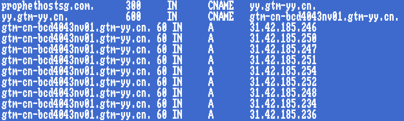

The first indication of second-tier infrastructure I encountered was the discovery of DNS CNAME records (Figure 5) mapping to just a handful of domains, their own content delivery network (CDN) of sorts.
Figure 5: I dig it, totally!
Having (dig) dug into a large number of domains identified through my earlier pivots, and armed with the CNAME records, it was time to delve into passive DNS (pDNS) and other data sources to determine what else might have been pointing their way.
Analysis of these CDN-like domains provided the golden key, unlocking links to over 9,000 domains, with at least a third seemingly active at any given time and new domains being added at a steady pace.

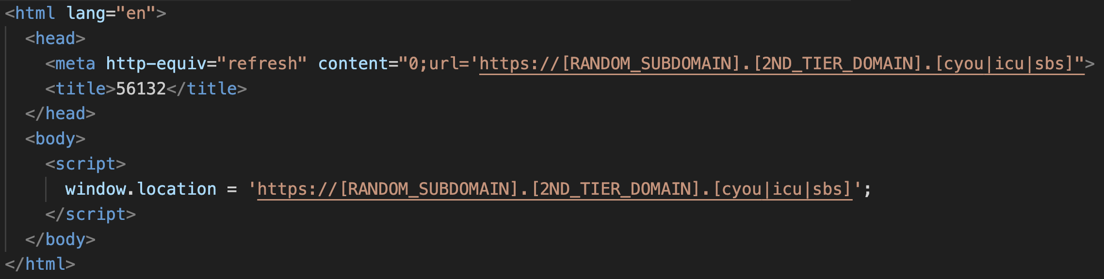

In many cases, and seemingly when using Cloudflare to front their scam domains, I observed sites redirecting visitors with either an HTTP 302 response or a combination of HTML and JavaScript (Figure 6).
Figure 6: HTML and JavaScript redirection
These redirections, similar to the CNAME method, take victims from the recognisable brand-mimicking domain to subdomains and domains that appear to be created by a registered domain generation algorithm (RDGA) and are predominantly under the top-level domains (TLDs) “.cyou,” “.icu” and “.sbs.” The structure and pattern of these domains suggest the use of automated tools to create and register them in bulk.

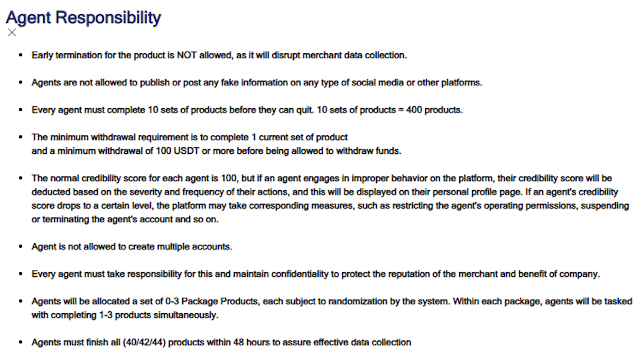

Having finally made it to the scam portal, I was prompted to register an account. Of note: A user could not do this without having first engaged with the scammer via WhatsApp. To prevent casual snooping, new accounts require a valid referral code. Without it you’ll be stuck staring at the main page.
Once registered, I was free to browse the site and marvel at the potential future job that awaited me. Unfortunately, having put off my “training” for far too long and neglecting my duties as a diligent employee, the scammer went cold and stopped answering my messages. Sad face.
Conversely, gaining access to the portal did provide enough leads and insights into their general operations, especially the help and tips sections (Figure 7).
![Figure7: Don’t worry (point 2)—this article is factual! [Scam portal]](/wp-content/uploads/work-hard-pay-harder-figure-7.png)
It seems that further exploration of the portal site and discovering what exactly the “job” entails will have to wait until I can find a new recruiter.

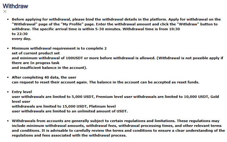

We’re not talking small numbers either, with the portal’s Withdraw help page (Figure 8) mentioning Tether amounts of 5,000 USDT, 10,000 USDT and 15,000 USDT: likely target amounts to try and squeeze out of each victim.
![Figure 8: Good luck withdrawing anything like these amounts [Scam portal]](/wp-content/uploads/work-hard-pay-harder-figure-8.png)
