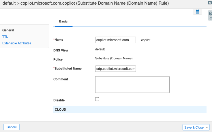

- Build a redirect DNS Firewall Response Policy Zone for each target (e.g., bing.com, copilot.microsoft.com).
- Create domain redirect rules to match records and perform necessary redirects (the CNAME targets recommended by Microsoft).
- Deploy these rules to the forwarding layer DNS appliances.

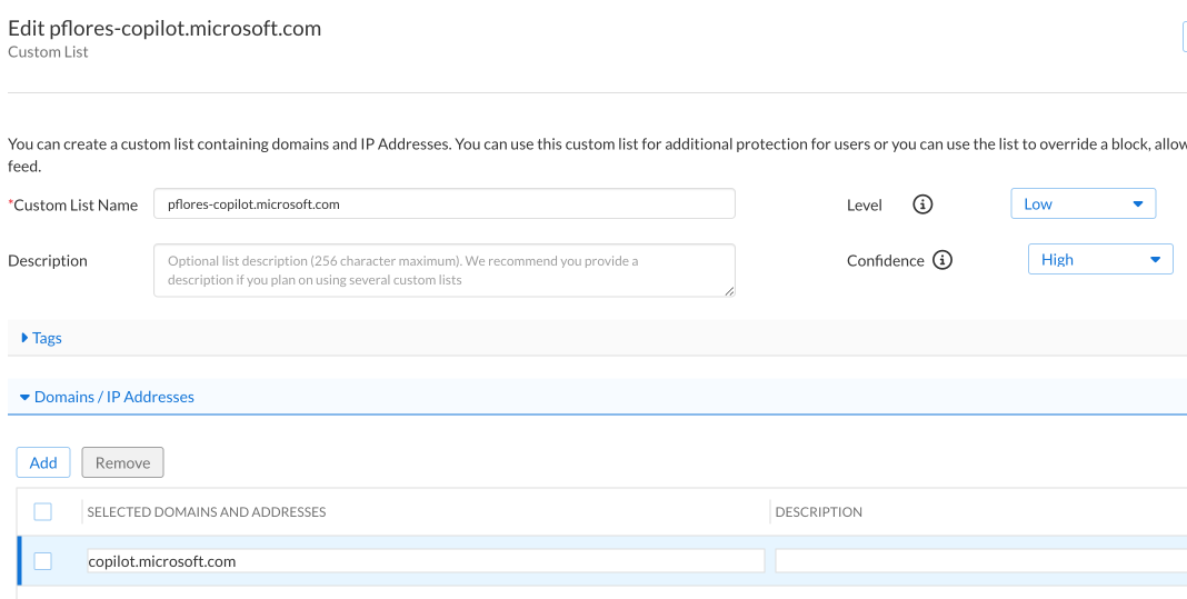

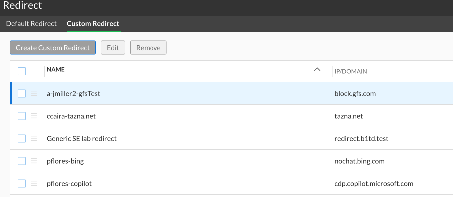

- Create custom redirect targets for both destinations nochat.bing.com and cdp.copilot.microsoft.com
- Create custom lists for www.bing.com and copilot.microsoft.com. These are used to match the query we want to redirect.

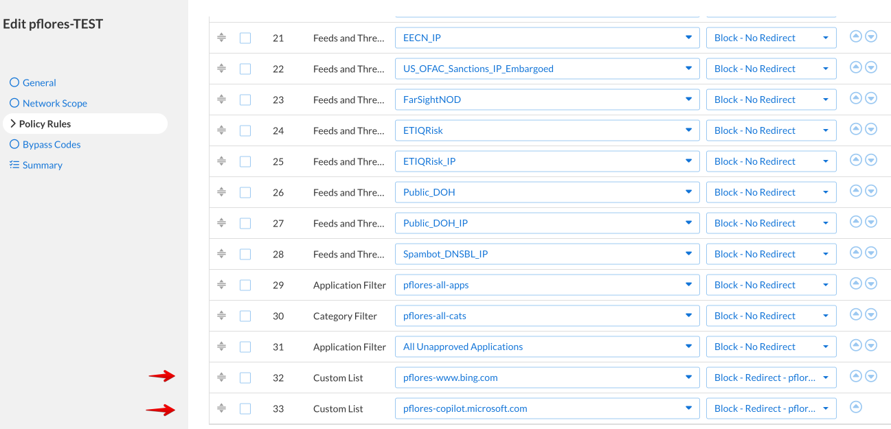

- Add the custom lists to your security policies, and pick the correct redirect that you created in the first step.
