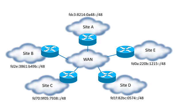

Here we arrive at all the same arguments we started with at the beginning of this post that Tom and Scott articulated in their blogs on ULA–namely, that the NAT66 + ULA design option is not gaining you any advantage. The pseudo-randomization of ULA Global IDs to form unique /48s (RFC 4193) will cause long-term scaling issues or, if ignored, potentially overlapping ULA address space (something with private IPv4 we have been trying to fix from the very beginning by using IPv6).
Figure 1 – Random ULA /48 Breaking Summarization

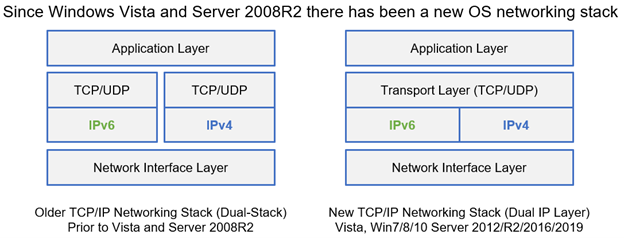

Also, for those running IPv6-only networks, you have additional considerations. There is one issue with IPv6-only (or IPv4-only networks) and Windows. Windows has a dual IP layer design for its network stack.
For Windows, this means it is not possible to turn off IPv6 or IPv4 in the networking stack. For Windows, even in IPv6-only network deployments, the host will still have an IPv4 address. It will have one because it will leverage the Automatic Private IP Addressing (APIPA) address range of 169.254.0.0/16 and auto-provision an IPv4 address on the host interface. For Linux and MacOS, it is possible to turn off the IPv4 stack and run in a true IPv6-only setup. The result is that you could have some very inconsistent behavior in some situations with Windows hosts during boot and initial setup. This could be very disruptive when trying to bring systems online.
The reverse is true also. In IPv4-only networks, the Windows host will automatically provision an IPv6 link-local address and start doing basic name discovery on the local link. This means Windows hosts will use Link Local Multicast Name Resolution (LLMNR) to discovery other Windows hosts and will exchange information via IPv6. Remember, IPv6 is on by default and is preferred by all operating systems, not just Windows. So even in IPv4-only networks today, there is still a lot of link-local IPv6-related traffic happening—often unbeknownst to the technical team operating both the network and hosts! Therefore, it is critical to understand the default setting for the OS and how the network is set up. Fire up a packet sniffer and see what IPv6 traffic you already have going on in your network. You might be surprised!
