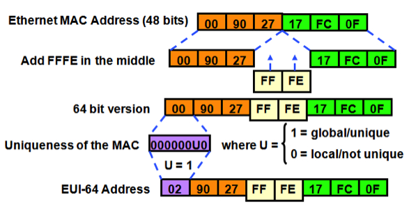

One technique for self-assigning the interface identifier of a node with stateless address auto-configuration uses the EUI-64 format. This format expands the node’s 48-bit Ethernet MAC address of its network interface to a 64-bit version by inserting “FFFE” in the middle. The 48-bit MAC address with the 16 bits of FFFE makes a 64-bit interface identifier.
To make sure that 64-bits of the chosen address is from a unique Ethernet MAC address, the universal/local ( “u” bit) is set to 1 for global scope and 0 for local scope. The motivation for inverting the “u” bit when forming the interface identifier is to make it easy for system administrators to hand configure local scope identifiers when hardware tokens are not available. This is expected to be the case for serial links, tunnel end-points, etc.
To make sure that the chosen address is from a unique Ethernet MAC address, a bit is set to identify the unique property of the 48-bit address. If the bit is 1, then uniqueness is guaranteed. An OR is applied to the first octet of the 64-bit address using the unique 8 bits template.
